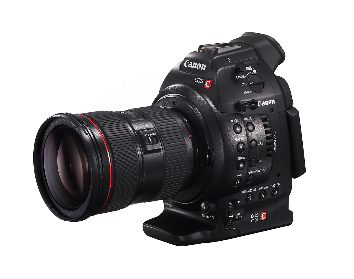

The Canon EOS C100 Digital Video camera is part of Canon’s Cinema EOS family of professional DSLR-based video cameras. It was introduced in late 2012 and sells for about $8000. It has an 8.3-megapixel “Super 35mm” 16:9 CMOS sensor and it’s compatible with all of Canon’s EF and EF-S lenses. The Dual Pixel CMOS AF upgrade adds a continuous auto focus area to the center of the C100’s frame. The area is about 20% of the height and 25% of the width of the frame. Canon says, “Dual Pixel CMOS AF technology helps provide smooth and consistent autofocus, so that pans are natural looking with subjects remaining focused even as they move.” Canon says the combination of phase detect and contrast detect auto focus also speeds up single-shot auto focus performance.

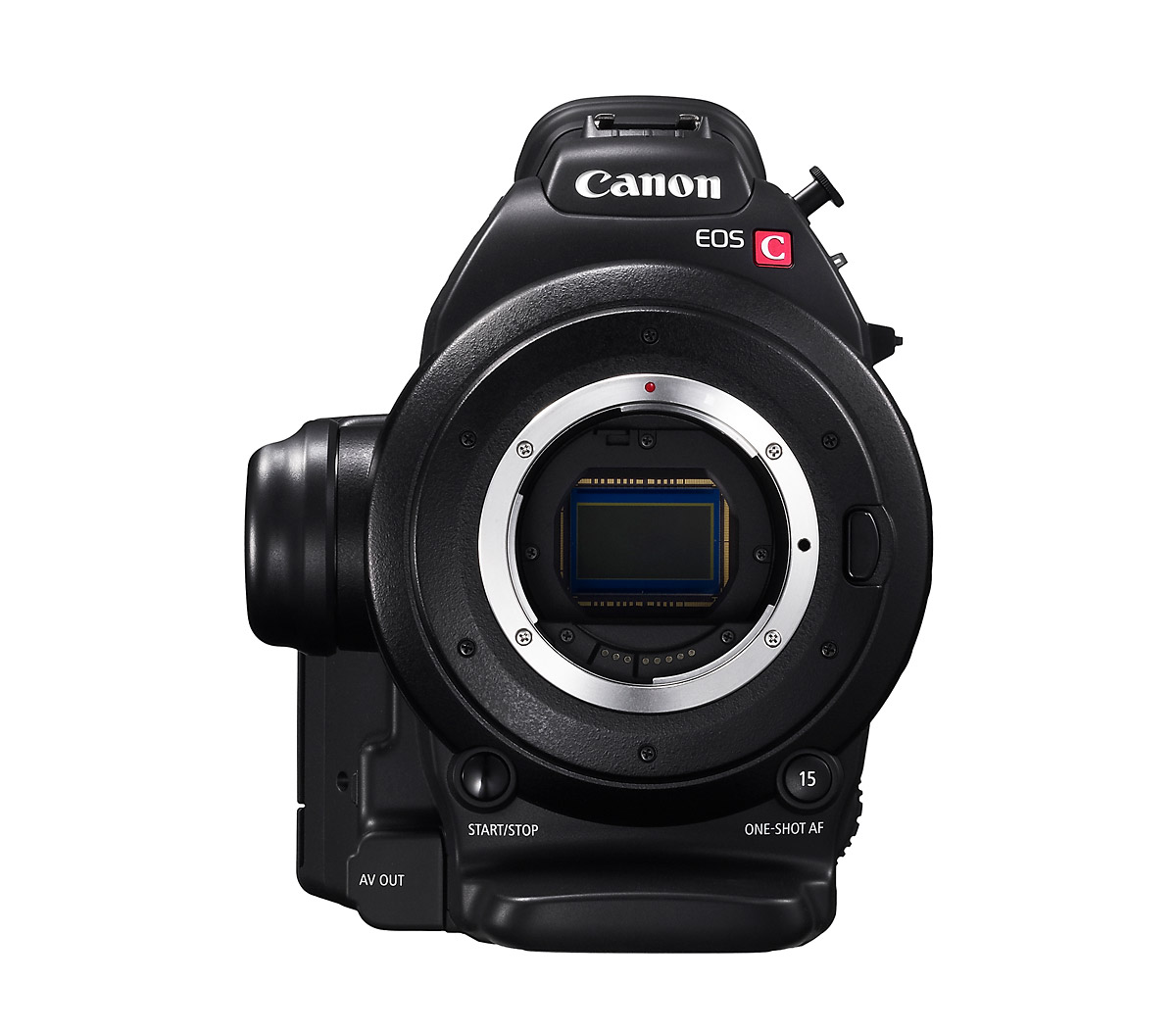

Besides adding the excellent EOS Movie Servo AF to the EOS C100, the Dual Pixel AF upgrade has some interesting implications. Adding Dual Pixel CMOS AF has to be more than just a firmware update. The sensor would have to be replaced as well – wouldn’t it? Apparently not. Thanks to DPReview for pointing this out because the Canon USA announcement is pretty vague, but Canon’s European press release says the C100 was designed with a Dual Pixel AF-compatible sensor. So much for this announcement being fuel for rumors of a new camera. It is a big deal for video, though. Until recently, Canon’s EOS Movie Servo AF was something you only got in consumer cameras like the EOS Rebel T5i / 700D. The EOS 70D was the first prosumer camera that got continuous auto focus for video. And now it will be available in Canon’s professional-level EOS Digital Video cameras, as well.
