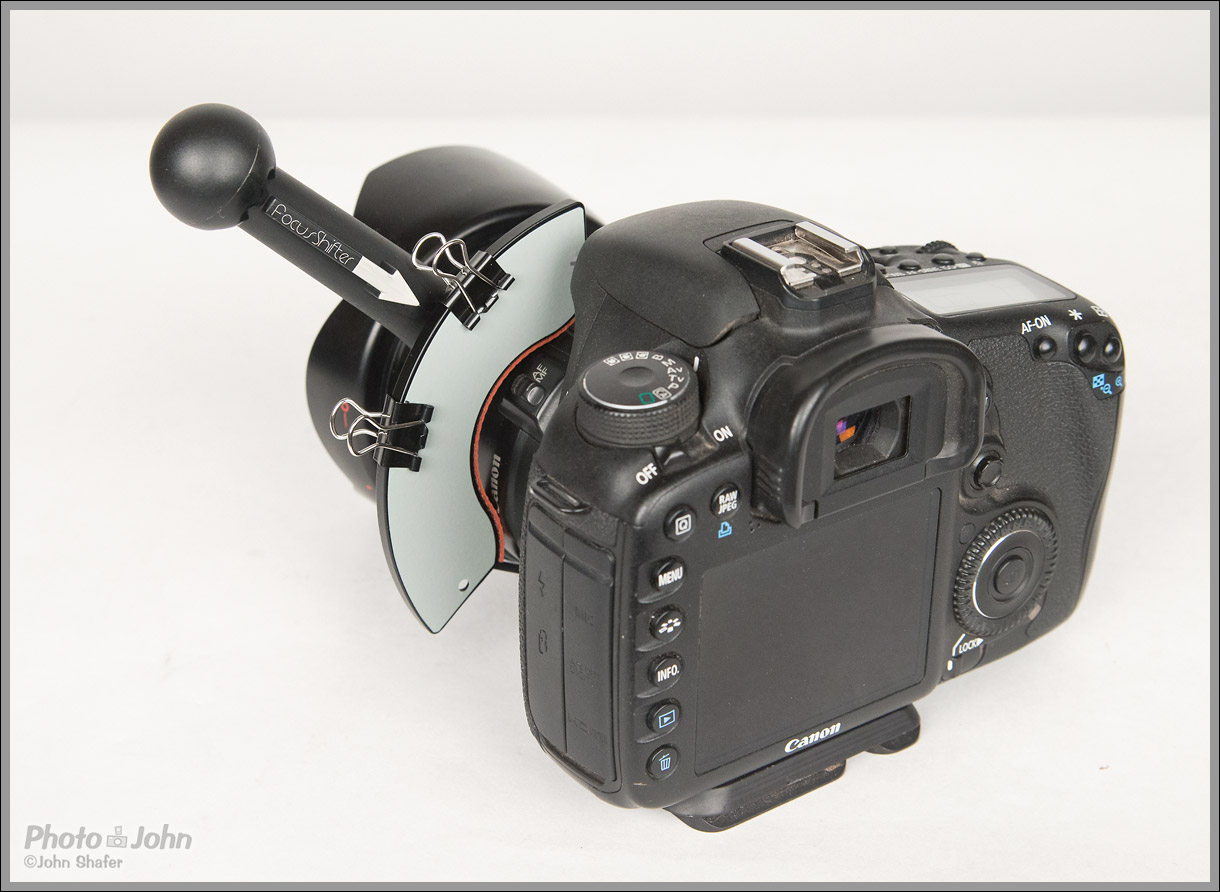

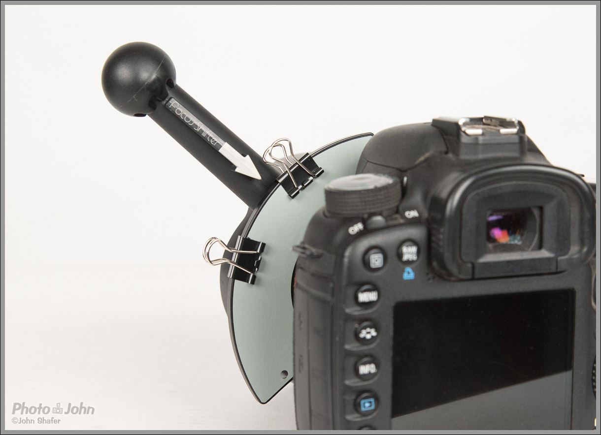

The Focus Shifter was actually a little more difficult to set up and use than I expected. But I think that’s more a reflection on my lack of video experience than the product itself. The truth is, making good video is a slow, deliberate process. For the most part, it’s not very spontaneous – especially not with a digital SLR. I think I expected the Focus Shifter would let me manually focus on the fly. But that’s not really the case. What it does, is allows you to set up video shots with pre-defined focus points, and then get a clean, relatively smooth focus pull without having to guess if you’re in focus or not. Actually, one of the big discoveries I made while I played with the Focus Shifter, is that the Marker Board is the most important part of the whole system. That’s where you mark your focus points – either with the provided dry erase pen, or with the provided clips, which act as hard stops. Once you’ve got your focus points set up on the Marker Board, you can be completely confident that both ends of your focus pull will be sharp.
Focus Shifter Follow Focus With Marker Board & Clip Hard Stops

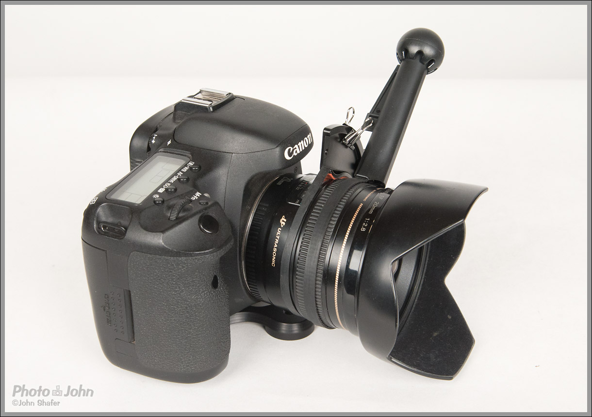

Focus Shifter Follow Focus With Canon 20mm f/2.8 Lens

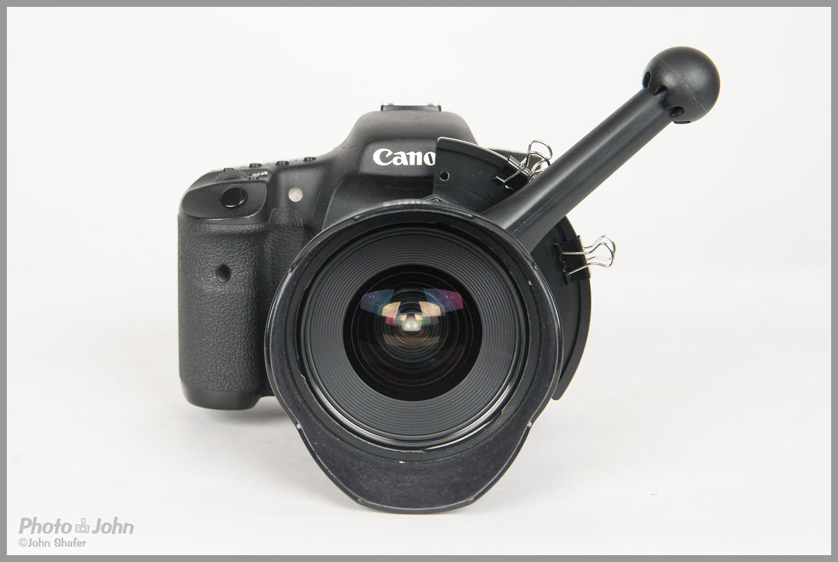

Focus Shifter Follow Focus On Canon EOS 7D

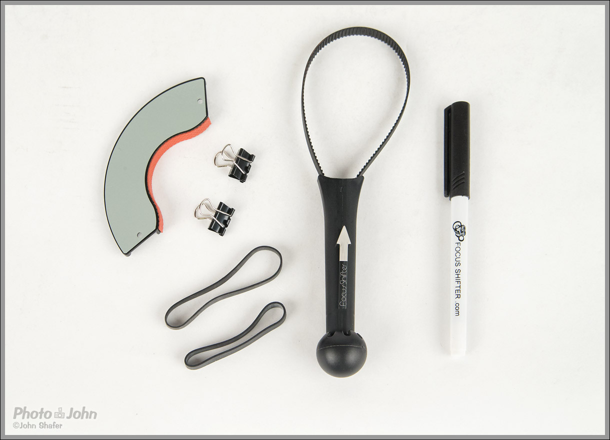

Focus Shifter Follow Focus - Parts

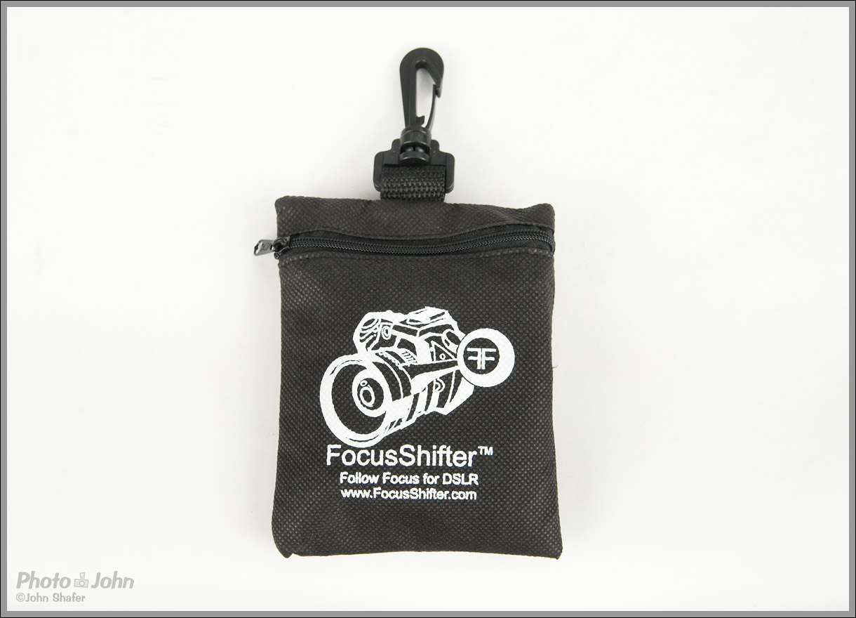

Focus Shifter Follow Focus - Bag
