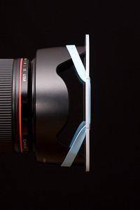

Phoxle SpectraSnap mountI find the lens-mounted filters preferable as you just have to be able to point your camera at your light source. The ExpoDisc is the king of this market, winning praise for its accuracy and the ease of slipping it over the end of your lens, but it comes at a steep price: around $100 per lens diameter. It also has it inconveniences: you have to take off your lens hood to use it and carry a separate ExpoDisc per lens diameter. I was delighted, then, to hear about Phoxle’s SpectraSnap white balance filter products. It maintains the ease of use of lens-mounted filters but eliminates my two major complaints: one size fits all of your lenses and it works with lens hoods. At $59.95, it’s a lot cheaper as well.
The original SpectraSnap filter is a 120mm white disc that attaches to the lens with a rubber band. The rubber band sounds cheap, but after much use of the product I honestly couldn’t think of anything else as versatile or effective. It attached easily to the lens hoods of my Canon 70-200mm f/2.8 and 16-35mm f/2.8 II lenses. You’re free to use it without the rubber band, in which case you have to hold it with your free hand. Using the SpectraSnap filter is very easy: attach the filter to your lens, point your camera at the light source you wish to balance against, take a photo, and then use your camera’s custom white balance settings to do the rest.
